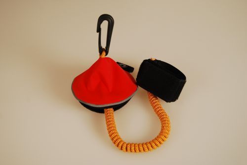

I would make my personal leash using ideas coming from other products. Idea is use a rope, carabiner with fast safety release to PFD or a velcro strap for ankle anchor point (to the sky you can use many things: another carabiner, a simple knot, etc.) and a small bag (as for throw bag).
Pros:
- rope lenght as you want
- simple
- strenght
- safe
Cons:
- you must wrap the rope into the bag every time you fall off (for experineced paddlers this should not be a big problem!)
- possible tangle of rope if non properly set in the bag
What do you think about?

I think your rope in a bag would be a major pain in the arse.
On the ski in 2 seconds, mess with silly rope for 2 minutes.

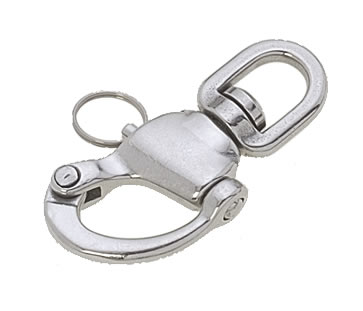

Be careful with the carabiners you choose, as some can come undone very easily if loaded and twisted.
You only need a release on your person, simply girth hitch it to your boat, simpler, cheaper, lighter and won't rattle against the boat and won't scratch it as well.

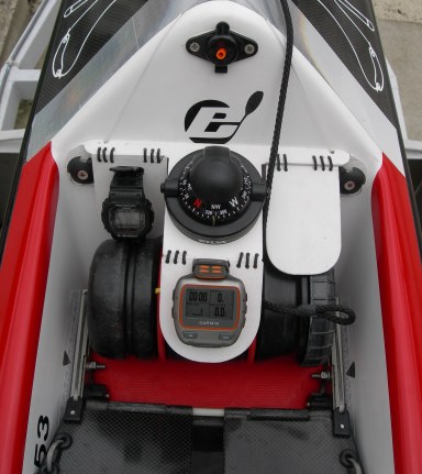

Coming back to the intial idea to put somethingh around in the footwell I found very interesting the brillant idea of … Didier! His blog (dplouepic.skyrock.com/) is a real mine of learning for all surfski’s mods. I sought a kind of roller leash (www.epickayaks.com/news/news/didiers-epi...nce-part-2--ouspoun-) but I don’t know how has been made and especially I don’t know if it works well or not. Do you have previous experience with this roll-up leash?

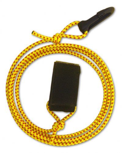

I always use a paddle leash - it's just habit now. It comprises 4mm light rope connected to the paddle with a loop which is held in place with a small piece of duct tape. The other end has a loop made of bungie which goes around the foot strap. The bungy is there to give a little shock absorption - so that if I do a wild lunging brace the paddle isn't plucked out of my hands...

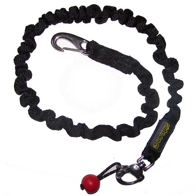

Offshore in big conditions I use a belt connected via a coiled leash either to the leash anchor if there is one or to the foot strap.
I've come off a number of times in fairly hectic downwind conditions and never had a tangle that I couldn't fix in seconds.
