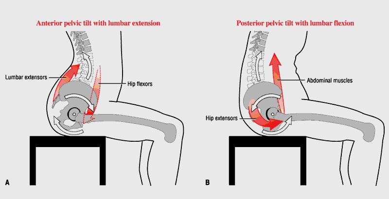

Is hard to understand the body mechanics without some picture. Found this one, and it makes perfect sense.
Hamstring is basically like a rope that connects the lower leg with the pelvic. When you straighten out the knee, the lower leg pulls on the hamstring muscle which tugs on the pelvic and rotates it backward. We don't want that. The solution is to bend the knee to let out some of that muscle to stop it from fighting the lumbar muscle to rotate the pelvic up.
I do find that bending the knee makes paddling more comfortable. Didn't know why until reading your description and seeing the picture.

Hi Wombat661
Excellent resource. Visualizing the details makes the explanation more accessible. Allow me to look around for an image of the pelvic region and the main players regarding posture, while seated.

Hi Wombat661
This simple diagram that I attached shows the concept of pelvic tilt from a sideways perspective.
Please keep in mind that the pelvis is able to move in two other directions that are evident while walking, but not so much on a ski.
What should concern us as paddlers is that the bucket can not play the role of a pelvic tilting device. If we could create such a surface on the ski's bucket, designed to prevent sliding down the bucket as consequence of tight hamstrings, this surface would need to be angled down towards the stern of the ski. Think of sitting in the hump. This would have the effect of further pushing the pelvis into posterior tilt!

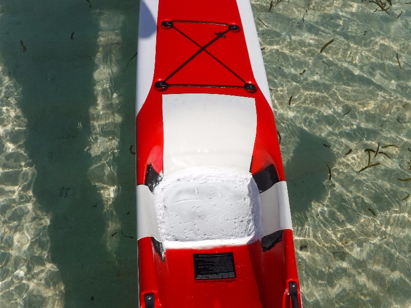

6 years 5 months ago #30343 by owenfromwales
Hi Mickey,
I reckon the most comfortable bum pads are ones you make yourself. Get the stuff in twelve inch square sheets, 5mm or 10 mm thickness, from a good hardware store. Cut each to shape and gradually build up. Silicon will hold it firmly in place whilst still allowing you to remove it one day without making a mess of your boat. The silicone can also be moulded on the sheet edges to smooth out any steps.
